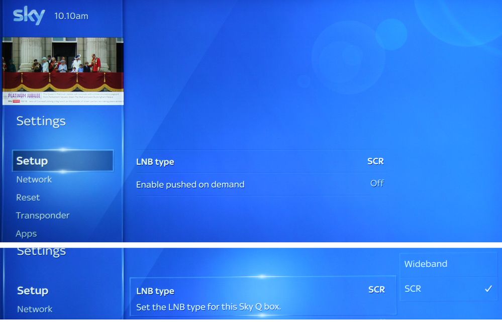

Resetting the settings will also reset:
Audio visual settings, such as picture resolution and HDMI control
Settings changed within the hidden engineer menu, include LNB type. If on a communal dish you need to reset the LNB to SCR in the hidden menu. After changing the LNB type you need to reboot the Q box.

Message posted on 06 Mar 2023 05:15 PM - last edited: 06 Mar 2023 05:20 PM
Re: TV Guide does not load
@AGodfrey123 Can you confirm that your LNB type is set to SCR
If it was showing Wideband, change the LNB type to SCR and then remove the mains power from your Sky Q receiver for 20 seconds and then restore mains power to your Sky Q receiver.
Message posted on 06 Mar 2023 05:15 PM - last edited: 06 Mar 2023 05:16 PM
@AGodfrey123 wrote:
Communal dish
Then you need change the LNB back to SCR @AGodfrey123
After doing this you need to power cycle the Q box
