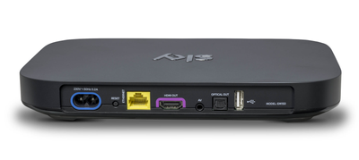

If that's a television without HDMI input then you'd need a Nokia CA-75U cable from eBay to plug into the AV minijack socket on the rear of the Mini box between the HDMI and optical audio ports..

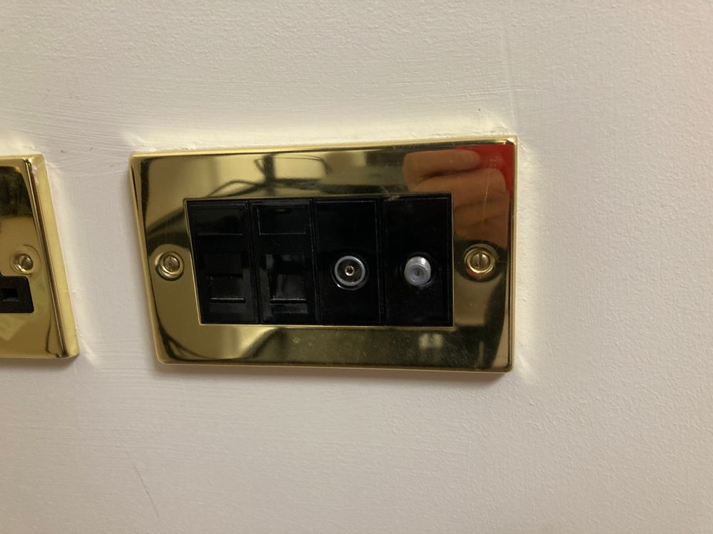

Photo of internal Sky Q port

I have the rooms wired to accept multi-room mini boxes
Mini boxes aren't intended to be 'wired', which is why they don't come with wires.
By default they use WiFi to connect with the main Q box.
You can, if you wish, put them on an ethernet distribution.
They don't have dish cables.

hi @Tom-44
SKY Mini boxes do not directly connect to the distribution system in your case (or dish for others)
They connect to the Main box via a network connection - wifi or ethernet - if your wifi is not SKY then it connects using a wifi signal generated by the main box
this is why you don;t have any additional cables to connect it to the wall
