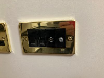

Photo of internal Sky Q port
That would generally be intended for the now outdated Sky+ Multiroom (single dish cable) rather than Sky Q Multiscreen (no dish feed)

Message posted on 30 Jan 2024 05:18 PM - last edited: 30 Jan 2024 05:43 PM
Re: I have SKYQ and 4 multi-screen boxes I have never used, as we just have one TV and main receiver
Note that it's an ethernet port on the faceplate which needs to be on the same data-cable distribution as the main Q box (and ideally the internet router) in a legitimate ethernet topology.
Unfortunately it's rather common for such faceplates to be wired somewhat randomly, or with cables run back to a semi-random location with no provision for an ethernet switch.
Message posted on 30 Jan 2024 05:41 PM
I'd also observe that unless there's some labelling or a diagram somewhere, random ethernet ports aren't necessarily helpful...
