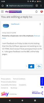

@Austinored wrote:Did they come back to you @trevforum
I didn't get a reply but they kept releasing new builds until it finally worked. By the way I changed to 8 bit and still got the UHD tags and it played in UHD/SDR.
