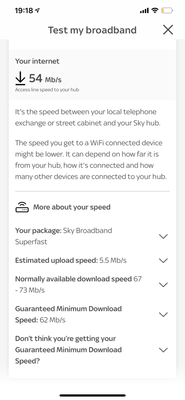

What is your guaranteed minimum downstream .  Your line attenuation suggests you should be closer to 75-80Mbps.  As downstream is guaranteed and upload isn't its better looked under downstream speed.
Can you run tests from my sky app and post details from more about your connection

As i thought.  A line issue and you are not hitting your minimum downstream. Contact sky on 150 from a landline
0333-7591-018 from any other phone to report and request line test and engineer
