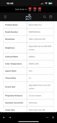

@MightyQuinn hi was looking help on how to get my sky q box working on my projector and I came arias your comment, I'm just wondering if you could help me these are the specs of my projector is it compatible for the sky q box, it's a movie mate pro FHD if that helps
