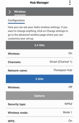

current settings attached - can you advise what to change from here please? Not even sure my 5 ghz is on 🤷🏻‍♀️
This message was authored by MightyQuinn This message was authored by: MightyQuinn
Re: Problem with sky q and bt discs - advice pls
Hi @LouiseThompson80   Yes, you have the 5 GHz band off!  Do you have the Complete WiFi discs (black) or the Whole Home discs (white)? If you have the Complete WiFi discs then they communicate with the SH2 using the 5 GHz band and you have it off. This could be the issue.

We have complete Wi-Fi with the black discs. Weirdly though, when I clicked into settings further it said that the "office disc" (that's the one upstairs) was connected to 5ghz, even though it appears to be off! Every single other device in the house is listed as being connected to 2.4. So please can you tell me what I need to do in idiot proof steps please?
I think I remember splitting into 5 and 2.4 a couple of years ago, when my son had a Wi-Fi lightbulb or something that wouldn't connect to whatever the original setting was.
But then I thought I read on another post that the smart hub 2 couldn't be split into 5 and 2.4, so now I'm even more confused!

It may be time to move over to the BT community to help you with your SH2. I would switch on 5 GHz and set it to channel 48. You can always reverse it.  https://community.bt.com  There are plenty of people there with Sky Q as well.
