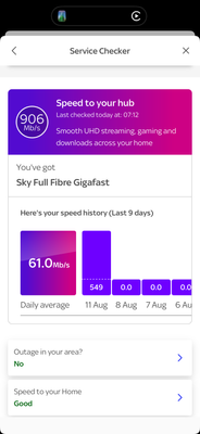

Message posted on 12 Aug 2026 05:34 PM
Re: WiFi dropping every few minute
I don't have permission to upload photos yet.
But it says.
Your Sky Broadband looks like it has a problem.
92.8 mb/s to your hub.
Nothing for Thu 7/8 - 8/8. Previous hub.
Same speed on 9/8, 10/8 & 12/8 92.8mb/s.

Message posted on 12 Aug 2026 06:50 PM
@KoiMan wrote:I don't have permission to upload photos yet.
But it says.
You're on 500Mbps I think? You need to be quoting those figures to Sky when you next chat with them, I'd consider the weedy wifi as a separate issue although that low a speed to the hub won't help.
