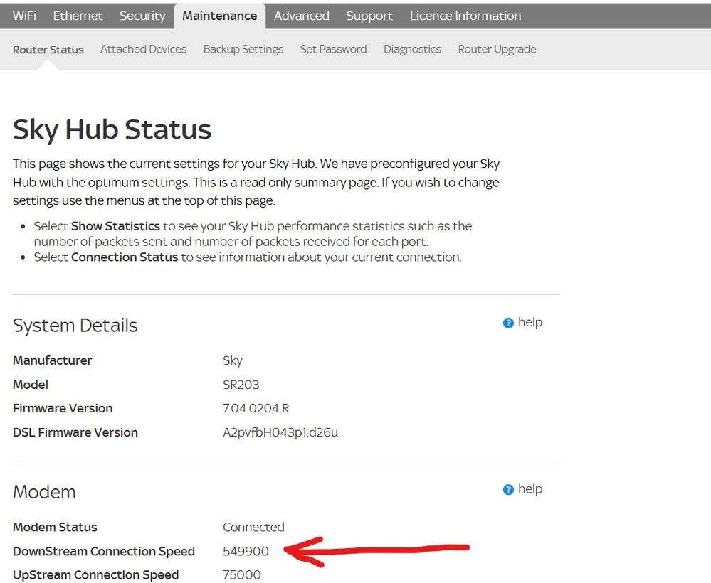

Try log onto the router page and check this.
32Mbs and 62Mbs are both "Fibre to cabinet" (FTTC). They come in 40/10 for lower and 80/20 upper tariff and based on distance from exchange.
I was on Talktalk 40/10 for few years and upgraded to 80/20. My speed never improved...after some complain, a Openreach engineer came round and stated my property is capped at 40/10 regardless what upgrade the ISP sells. Hopefully yours is not capped 🤗

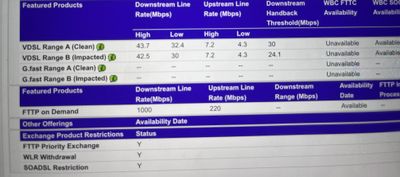

Could you enter your full address in the link below and post the table after removing you address from the image

Advertising standards still allow isp to quote the national average speed for people with the same connection type. Hoeever if this is still dlm training the link should get a better idea of what speed they will get

I.dont have that hub so don't have that maintenance tab

aye looks like 43.7 is going to be the upper limit
Message posted on 06 Sep 2025 11:34 PM
Re: Speed upgrade not quicker
Realistically due to the fact that the hub is optimising the speed you should get 40 mbps per the vdsl rows

@AlbaZeus Those line stats were similar to mine so you will never really see anything above 35Mbs. You may get 40Mbs if you live next door to the exchange 😊
Are you not able to get FTTP now. They are just as cheap as FTTC now. Thesedays 150Mbs FTTP is selling about £24 with Sky, Vodafone and Plusnet.
