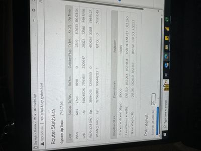

Anyway - I have tried one of the new routers as well as my old one and I am still getting the orange light a few times a day. It is still the same where it goes down for 30-60 seconds at a time.
Here are my stats from this morning - is there still an issue that needs the engineer to come back out, or is it the fact I am using an obsolete router (model ER115)

Message posted on 17 Oct 2024 09:46 AM
Re: Broadband orange light everyday
Your router isnt obsolete yet. It will be in the next couple years but right now it should work fine and if you've had two replacements you would think it can't be the router.
