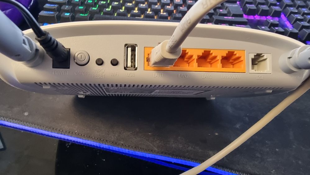

@jamesn123 Right thanks - we were both typing at once haha! I'll do what you suggest but I always connect the Asus Router's WAN Port to the Port 1 on the modem - the one which says WAN/LAN - I use a std LAN Port when connecting My PC to either of them.

Re: New 3rd Party Router - To Improve WiFi
Thats not the right one. You want to connect it to LAN1 which is the opposite side to the one labeled LAN4/WAN on the TP-Link modem. See my picture below

@jamesn123regarding the Modem to Asus Router connection - is that critical as after all the port I'm plugging the cable into on the modem is a WAN/LAN port so it does both? Whilst I will change it, it will be good to know going forwards

The port you conect to is dependant on your WAN configuration on the modem, since yours is slightly different to mine then I'd leave it in whatever port is working for you

If you have a white light on the Asus then the internet has been established and you are good to go on the Asus XT8 and its wireless mesh. It really doesn't matter which LAN port you are using. Any further help or questions you have with the Asus and the wireless mesh please don't hesitate to ask. Great, it is at last working... 😀
