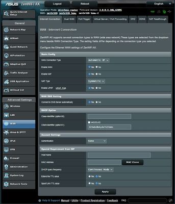

Right then so far this morning I've decided for now, to leave the Modem's ip address as it is, namely: - 192.168.1.1 as I did have Internet before I messed with the WAN's settings.
I've reset the WAN's settings to what they were first thing yesterday - see screenshot: -

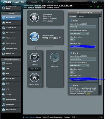

And have internet 😁: -
AND what's even better, I'm typing in this thread now using the Asus Router's Internet - WooHoo!!!!!

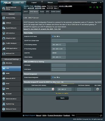

OK so over to the LAN - first up I changed the Gateway: -
As youcan see so far so good.  Then on to the Lan's DHCP Tab: -

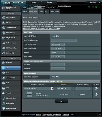

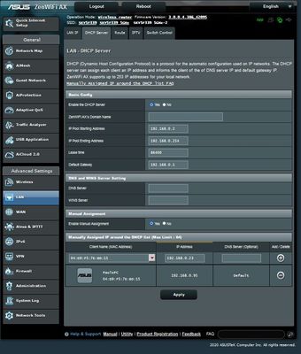

I then tried to add 192.168.0.23 for my PC. When I first clicked "Apply", I got an error message saying "You cannot leave fields blank".  I tried a few things and eventually the Router saved the settings and after re-logging in this is what I see: -
And then this: -
For some reason I've messed with the devices - the MAC address ending "15" is my PC (confirmed by looking at what it is in the Sky Hub) and the one ending "30" is the XT8 itself, but that now seems to have disappeared!
And I seem unable to change my PC's ip to 192.168.0.23 - every time I Save, the Router resets and comes back up showing that it is 192.168.0.95, which is what it was at the beginning.

@rozel
Usually, it is best to allocate a fixed IP address to its current LAN IP setting for that client device, and the reason you are having issues changing the IP to a different fixed IP address is it is already in use by another device.
