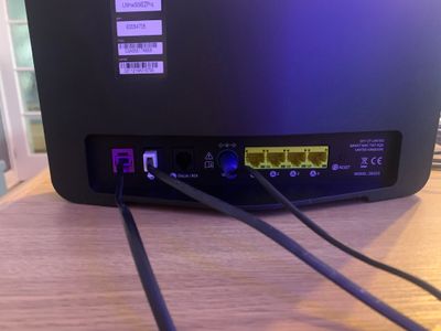

Having gone through these there appears to be only 1 port available on the ont, as the other cable supplied fits the old open reach box, there are no yellow connectors, so what plug goes to either number 4 or the purple connectors, no internet after connecting

 This is the set up we have done  added it all but no internet connection or phone line

Re: Black router
Hi @Chloe142  First turn off the power to the Hub.
You have an ONT so the old Openreach socket is redundant and doesn't do anything. The purple ended connector plugged into the Hub's Broadband socket doesn't do anything either, so you can remove it.
If the cable plugged into the UK Phone socket at the back of the Hub is connected to your phone, that's correct.
The power cable is ok.
All you need is an ethernet cable - the one with yellow connectors at each end. One end goes into the ONT socket labelled PORT or LAN. The other end goes into the socket marked '4' at the back of your Hub.
Turn on the Hub's power back on and hopefully all the lights on the Hub will go green after a few minutes.

Re: Black router
Hi mark thanks for all the info, finally after more than 3 months we have a landline, I hope that compensation will be paid. Also what benefits of the white hub are we losing out on thanks again
