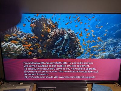

I'm getting this notification when I record a program from BBC One onto my Sky+HD box, however I do not see if when I watch BBC One live.
According to the website my box should be getting BBC One HD on channel 101, and so I don't understand why I'm getting this on a recorded program.
Can you please advise what I have to do to be able to record BBC One programs without losing the lower third?

Thay would suggest you're viewing the BBC1 HD channel, but recording the SD channel.

@Mark39As far as I know I'm recording the same channel both times.  However, I have just noticed on my Sky Go app, channel 101 just says BBC One, whereas on my Sky+HD box, channel 101 says BBC One HD.
Is it possible that the Sky Go app is sending incorrect instructions to the Sky+HD box?
Re: BBC Upgrade banner on recording but not while watching live
Yes I would say that is probably what is happening as the HD versions of the channels via Sky Go are not always in the correct place so try looking from 951 onwards for the HD version of BBC One via the app.

Yes, I would say the channel you're selecting on Sky Go is the SD channel. I think I remember seeing other posts who have had the same issue.

That's not correct, BBC One HD is a free channel and can be recorded without the HD pack. If you're using Sky Go to set remote recordings, you should find BBC One HD on 801 rather than 101.
