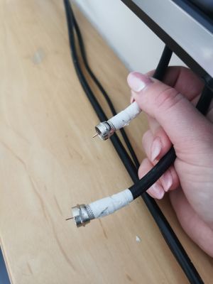

These are the new cables that have been installed. These have been extended from the original cables. They were labelled as satellite cables in the package

@DanielleVic This is what a correctly terminated F connector should resemble, note the length of the extended inner conductor should only be around 2 mm, your photograph suggests that your electrician has left the inner conductor a bit too long.
