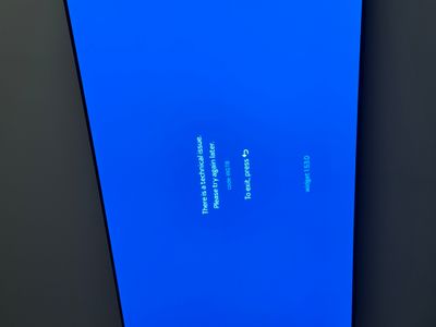

Is anyone else getting this error trying to watch a game of Sky sports plus?

Message posted on 13 Aug 2024 07:35 PM
Re: Sky Sports Plus Error
While we wait for the image to clear moderation, which stream is it so I can test?

I'm trying to watch Charlton v Birmingham but it happens on every stream.
Sky sports football fine for the Wrexham game. As soon as I press the red button for match choice, the error appears. I can watch on my mobile app, but want to watch on the tv!
Any help appreciated!
Message posted on 13 Aug 2024 07:38 PM - last edited: 13 Aug 2024 07:39 PM
Can see the image but I cannot replicate the error @Spitfire1000
You are not trying to watch a game that hasn't started yet are you? Think they are 7:45 kick offs.

Will check that now.

The Charlton game is definitely a 19:45 kick off.

The coverage has started though. Just checked the sky sports app on my phone.
Message posted on 13 Aug 2024 07:46 PM - last edited: 13 Aug 2024 07:46 PM
@Spitfire1000 wrote:The coverage has started though. Just checked the sky sports app on my phone.
Yep, I am watching on Q now without issue.
Have you tried the steps recommended by @oldfella ?
Or at least try a full power cycle on the box (unplug at the mains for 5 minutes).
LG B6 OLED 55” | LG UP75 LCD 43” | Sky Q | Sky Q Mini | SONOS Beam | EE Apple TV 4K | EE Full Works FTTC
Message posted on 13 Aug 2024 07:49 PM
Trying a software update now. Thanks for your help. Will see if that does the trick!
Assume you checked first that it isn't already on the latest version?
Next thing to try is to refresh the Apps in the Hidden menu.
To enter hidden menu press Home and navigate down to Settings but do not select Settings.
With Settings highlighted press 0 0 1 Select.
Select Apps
then highlight Refresh all Apps on this box.
You'll see a message that says, 'Your apps are being refreshed'. This will stay on screen until you press Dismiss to return to normal viewing
It’s recommended waiting at least 5 minutes before doing so.
Refresh Apps can take up to 24 hrs to complete .
Message posted on 13 Aug 2024 08:01 PM
All sorted! Thanks OldFella. Was running ancient software probably!
