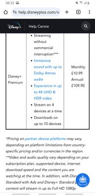

Fair comment @Jeepyrover even if you have a UHD HDR tv with the Disney+ app installed unless you have the right plan subscription you still wouldn't get UHD via Disney+ on Sky Q either
Plan 1 subscription £4.99 Disney+ Standard with Ads
Plan 2 subscription £7.99 Disney+ Standard
Plan 3 subscription £10.99 Disney + Premium
