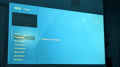

No signal for 2 days now on the mini q box.

As person above posted, shut down all box's (main and mini box's) wait at least 1 minute, then restart your main box ONLY, let it boot up and then set it up (i also had to reset my internet as well), once thats done go through making sure everythinsg right, then and only then restart your mini box (i am not sure if you can restart all the mini box's at the same time or have to go individually), then set it all up.
That should work, it worked for me (SkyQ) and yes was an absolute pain in the butt.

Ok so I rebooted main q box last night by unplugging leaving for 30 secs plugged back in then did same on mini boxes mine is now working

I have a possible solution!
After an hour with an advisor he suggested a 'hail mary' and it worked for me.
Aparently the solution to reset everything is for Sky Broadband users, which I am not.
Restart your mini box
when you get to the ...'I need to ask you three questions'
Question 1 is ... 'Is this a new installation' (or similar) you would normaly select NO and move onto broadband questions.
Select YES, New installation. New Box or whatever. It will then re-install and this time it works (for me)
Neither me or the tech chat fella knew why this works but it certainly did for me, a NON Sky Broadband user.
I hope this helps those struggling.
