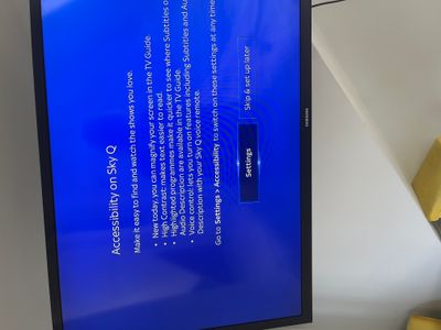

Mini box stuck on this

@Tcook8
Sky have suggested the following...
  • Unpair their Sky Q remote from the box by holding 4&6
  • Wait for the remote to flash
  • Then dismiss the information screen "Skip & set up later"
  • Hold 1&3 to repair the remote control
If 4&6 does not allow you to clear the information screen, try holding 7&9 to reset the Sky Q remote then hold 1&3 and follow the on-screen setup journey to allow the remote to control the TV.

Re: Mini box stuck on this
Brilliant it worked but thank you thanks
