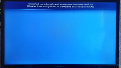

Hi, I have had my sky mini box for years. I woke this morning to find that it is telling me to "Please check your subscription entitles you to..." My main box is fine and is working perfectly. I cannot access any channels or recordings only the apps. I have reset my box multiple times, unplugged it from the sockets everything to no avail. I literally cannot find a way to get a hold of customer serviced

Hi @Ayk88
First try rebooting the main Q box and then when this is completely back up and running reboot the mini.
Reboot the mini as above.
If the mini still does not connect try a Network Reset on the mini.
Network Reset found in mini Home - Settings - Setup - Network.
Highlight Status and then select Reset on the right hand side. Follow instructions to WPS with main Q box.
You will be asked to press the WPS button on the main Q box (not the mini as the Network reset will start the mini WPS automatically).
If you are on Sky Broadband and the Router is nearer to the mini than the main box then you can try pressing WPS on the router instead of the main Q box. If you do this make sure you press the Sky router WPS button and not the router reset button.

Hi @Ayk88
Try a Reset Settings in the main Q box hidden menu.
To enter hidden menu press Home and navigate down to Settings but do not select Settings.
With Settings highlighted press 0 0 1 Select.
Only Carry out the first Reset (Reset Settings) as the other two will wipe all recordings.
After the Reset you will have to re pair your Bluetooth remote If you use one.
If you cannot switch the Q box on with the remote after the Reset press the Standby button (Amber led) on the front of the box.
To re pair the remote press 1 & 3 together on the remote and follow onscreen instructions to re pair.
Make sure that you are pointing the remote at the Q box when you press 1 & 3 together.
Resetting the settings will also reset:
Audio visual settings, such as picture resolution and HDMI control
Settings changed within the hidden engineer menu, include LNB type. If on a communal dish you need to reset the LNB to SCR in the hidden menu. After changing the LNB type you need to reboot the Q box.
When the main Q box is completely back up and running reboot the mini again

Hi @Ayk88
In your Main Q box.
Home menu - Settings - Status.
Does Watch on Sky Q Mini Box have a tick?
Even if it does Select it and then Select Reactivate on the right hand side.
The other thing to try is to refresh your Viewing card.
Home - Settings - System info.
Highlight Viewing card number and then select Setup on the right hand side.
Then select Use this option to trigger a callback
No call is actually made but the Viewing card should be refreshed.
