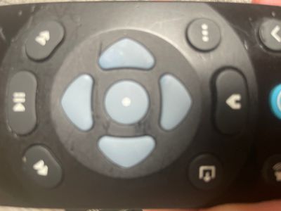

Hi, has anyone else experienced issues changing channels from Channel 4 using grey the circle then arrow buttons on the sky remote?
Whenever we try we are being defaulted onto the C4 app - which we've never even registered on?
does that make sense ?

If you hit the 'grey circle' (select) when the 'start programme from the beginning' is displayed then it fires up the relevant streaming app.
You can wait for the banner to disappear or dismiss it with 'back'. Or don't hit the select button at all when using the up and down arrows to preview channels.

I've also found rather than pressing the select button (middle button) if you press the info button to bring up the mini guide then scroll through the mini guide and press select to switch to a channel this works and switches you to the channel rather than bringing up the ch4 app
