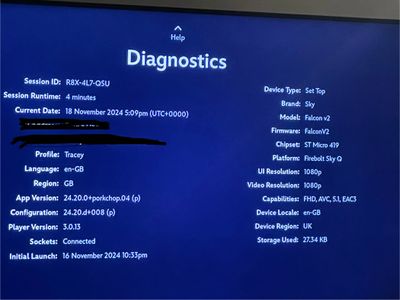

I will fully reply later with all details requested. Just wanted to add that if I change my SkyQ viewing resolution to 1080p it works. I change back to 2160UHD and it's black screen again. To confirm I do have the full Disney+ premium subscription and pay UHD to Sky. I was also trying with Home Alone 2 which is not even a UHD film.
i also checked the app diagnostics (photo below) and it says resolution is only 1080p. So is this the problem? Your app version is suddenly only 1080p (in the past week as it was working fine last week) when the Sky Q box and tv both support higher?

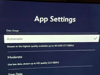

  7. Changing sky Q to 1080p means I can watch the failing shows again. So does leaving Q box on uhd 8bit with Disney+ app settings > Data usage set to lowest (SD)
So there is a workaround but not really what we expect from these products as we're paying for UHD on both Sky and Disney+
Whatever setting I have on sky Q (4k or 1080p) the automatic data usage setting in Disney+ always says highest available is HD (4gb per hour)

@Daniel-F
  1. App version 24.20.0+porkchop.04(p)
  2. No error message. I can log in and choose something to watch, play trailers, but when I select to play MOST things, it’s just a black screen, no audio. I can ffwd and see the thumbnail above progress bar but when press play, main screen still black.
  3. Deadpool & Wolverine, Home Alone 1&2, Die Hard 1&2, Muppet Christmas Carol to name a few. Jingle All the Way did play.
  4. BT Broadband connected via WiFi
  5. Toshiba 49U6663DB 4K UHD
  6. Tested on 2160 both 10 bit and 8 bit. Also tested on 1080.
  7. Changing SkyQ resolution to 1080 worked, but this is not an acceptable long term solution as I pay UHD subscriptions for both Sky and Disney+ and it was all working fine at 2160 until last week.
I also attach a screenshot of the Disney+ diagnostic page which shows the app resolution is only 1080. Is this the problem?

@Nick+Reffell wrote:
Daniel-F wrote:
Marking this as the best answer (for now) so that the message can be found for fellow users also experiencing this issue.
Yes that is obviously understood but it points towards a root cause.
That last point is interesting. Here's mine (which works fine)
Was this when the box was in 1080p or 4k? And were you playing uhd content at the time?

Re: Disney+ black screen
@amnada12 wrote:
Yes it stops working if you swap back to uhd, if you keep the HD setting you cant watch anything in uhd . You have  to swap between the 2 settings.  🙁
When you are in 2160p do you get the same thing on the data setting as Nick Refell's post above where the Automatic setting says it will max out at HD 4GB/hour?
This message was authored by: Trace+Em
@Chodley
App diagnostics were the same whether the box was in 2160 or 1080.
App settings are also automatic, best available up to 4K as in image above.
Diagnostics screen is from home menu, when not screening anything. But I tried both UHD and standard content when the box was in 2160.  Neither worked. Additionally the box has always been set at 2160 and I streamed Disney+ content in UHD and standard with no issues until last week.
