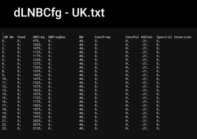

I contacted GT-SAT and they advised me to down the below as a text file from their Website and try that which I did and still had no luck can you please ping me your mobile number in a private message to contact you if you don't mind.
Message posted on 07 Mar 2024 01:48 PM - last edited: 07 Mar 2024 03:27 PM
Re: 2 receivers on the same scr communal dish
@Shammy7861 The text file that appeared for a few minutes in your last message, before it disappeared, was unfortunately just the default factory parameters and none of those User Band frequencies matched the Sky Q receiver specification, so that most certainly would stand no chance of working.

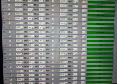

@Shammy7861 When you programmed the Sky UK User Band frequencies can you confirm that you selected each User Band to use 'Dynamic' mode.
Godfrey.
Message posted on 07 Mar 2024 05:19 PM
@Godfrey Please the the attached screenshot I've just take for you.
I tried to see I'd setting UB 4 to UB 25 freq and UB 5 to UB 26 freq would make a difference but did nothing.
Thanks Sham
