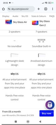

@Ray572 wrote:
today I was told by sky that voice control without the remote is not available on the air tv!
That's not correct.  Both Glass Gen 2 and Glass Air have hands free voice control, as listed on the Sky side-by-side comparison.
https://www.sky.com/glass/air

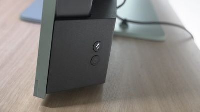

@Ray572
Also check the 'disable microphone' button on the chassis  hasn't been accidentally toggled
