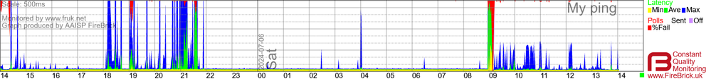

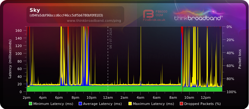

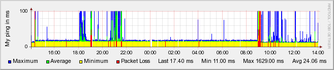

As you can see from BQM and F8lure, the connection doesn't look great, this is with browsing mainly

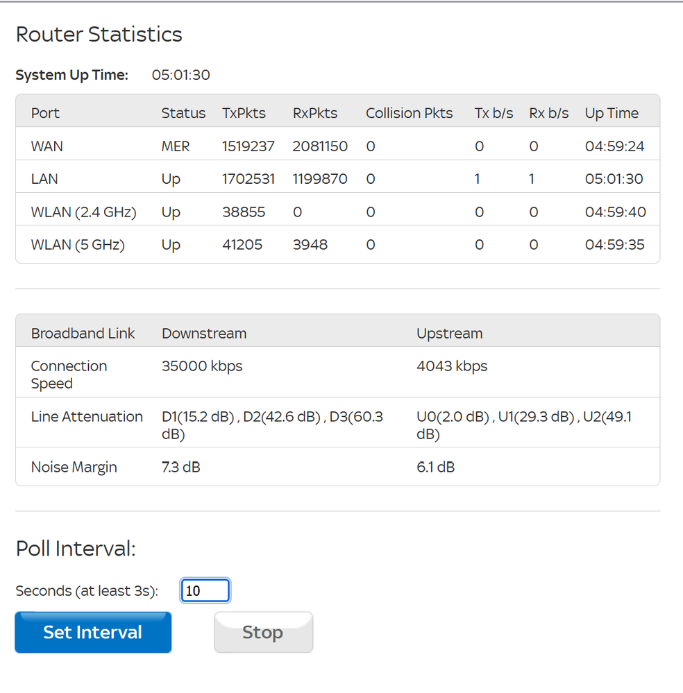

@Anonymous
Could you post your hub stats

Re: not getting minimum guarantee speed
Are these them?

@Anonymous
Looks like a line re-sync were throughout the night the green minimum latency increased . This could be enough to drop the line and decrease your speed below your guarantee. Other than that during the period of lower minimum latency you speed is showing 35Mbps per your router
I strongly recommend you let (usually the network team) investigate in the background.  They where good for me when my bqm was up the left and solved it so they are knowledgeable

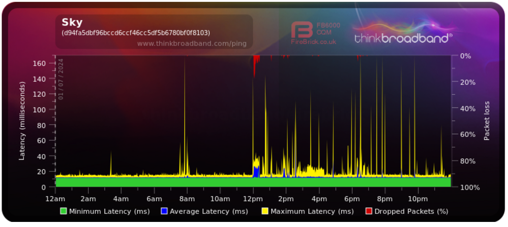

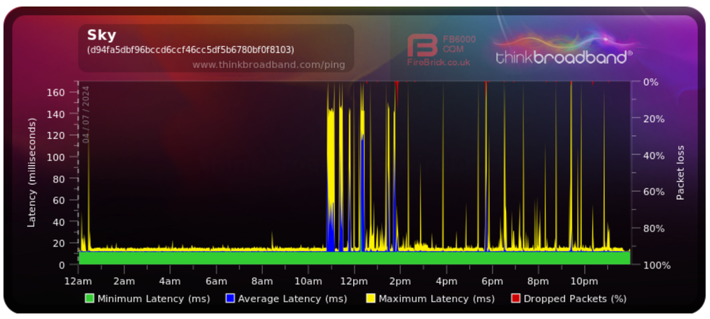

Hi,
Thanks for the reply, however it not just today, it just not been great the past month
Below is from the 4th July, while not as bad, but everytime I go to gaming, it spikes up, regardless if that on PC or Xbox.
It is fine during the night,  which isn't much good to me when I am sleeping
4th July
1st July
@Anonymous
The BQM's are virtually pointless on Sky routers because the ping response is of least priority to Sky hubs. Therefore you are seeing 'spikes' when you are using the connection because the Sky hub is dealing with your requests first.
