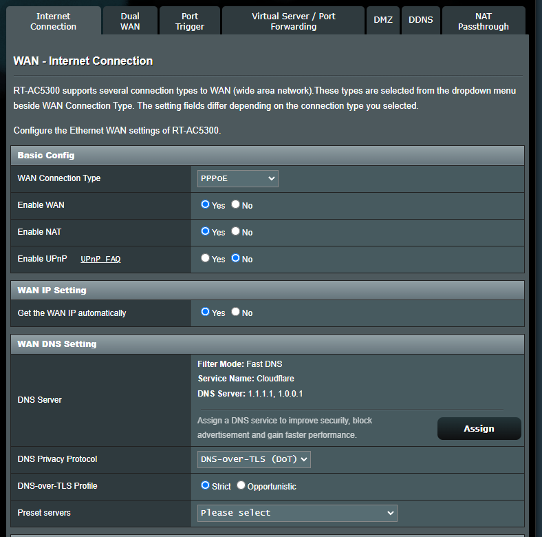

Hey, I am switching from Vodafone over to Sky Gigafast, I currently have my Asus router connected directly to the Open Reach ONT box. I would be grateful if someone could provide me with the router setting I would need to change to use it with SKY.
The router runs on the latest asus firmware. Screenshot included below.

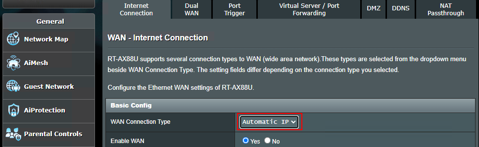

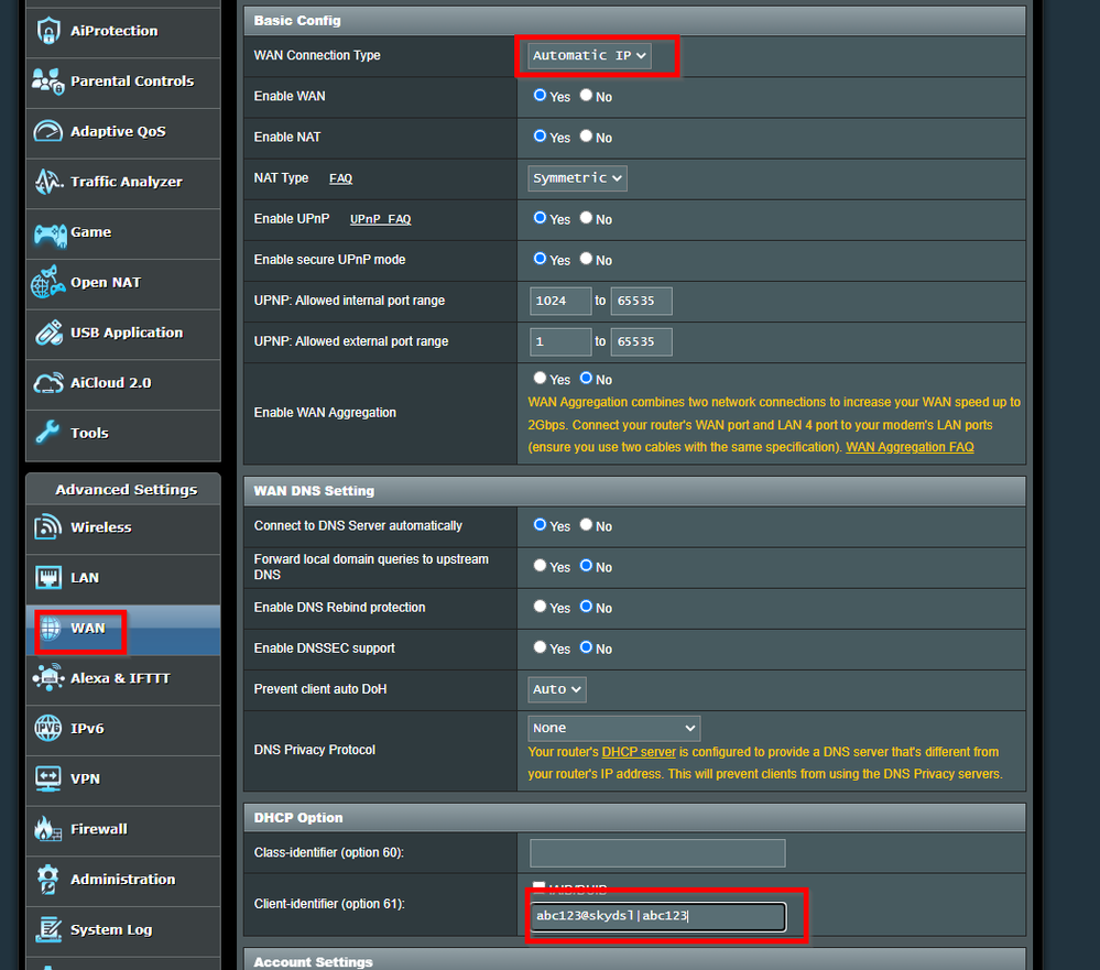

Okay so WAN should be set to 'Automatic IP' not PPPoE like it is at the moment.

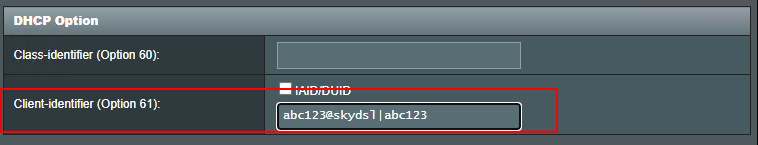

Then in the DHCP Option 61 box put abc123@skydsl|abc123

@Brownbear1710 Here is some screenshots from my router to help you out
