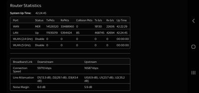

@Aleksandrorlov Please can you post your router stats so the forum can advise on any issues. This link explains how to do that https://helpforum.sky.com/t5/Broadband/How-to-find-your-Sky-Broadband-router-stats/td-p/2855717#
These would show any fault.

Message posted on 28 Feb 2024 02:49 PM
Re: Sudden Change In Speeds
Attached as requested
Message posted on 28 Feb 2024 02:50 PM
@GD1 Attached above, appreciate your help
Message posted on 28 Feb 2024 03:49 PM
The VDSL2 broadband line is about 650 metres from the cabinet and you are at just under 60Mbps downstream. Even though this is less than the previous speed you had at 70Mbps it is about right for distance and a moderate amount of cross-talk from other lines in the bundle and there is little that can be done to improve the situation unless lines get disconnected with the uptake of FTTP.
Message posted on 28 Feb 2024 03:58 PM
@mae-3 How did you get that info from my statistics?
Message posted on 28 Feb 2024 04:04 PM
The actual cable length to the cabinet distance on a non-faulty line can be calculated based on the frequency response from each of the three bands with its wavelength properties and dB attenuation.
