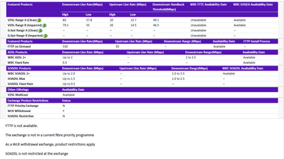

@YRogers Please can you post the results from this link 1st remove any address info before posting.

Thanks for your response. here is the results

It certainly appears 80/20Mbs should be available as well as 40/10.
Is it possible you're signed up to the Social Tariff broadband product? That's capped to the lower band.

Isp's usually reserve lower speed slots in the cabinet for people who just need 40Mbps so that they can lease/purchase them for less than an 80Mbps so it is possible that there are 40Mbps slots available whilst the full 80Mbps slots are all taken up. Unfortunately there's no way on the checker to differentiate 80Mbps slot from 40Mbps slot availability. So you would probably just need to keep checking with sky

@cookiemonsteruk from the cabinet checker i should in theory have speeds up to 330Mbps:
Annoyingly i don't have permission to upload images but my information can be found here: Cabinet Information Screenshot
