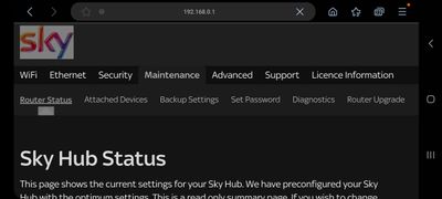

Avatar for Davidgbee
This message was authored by: Davidgbee
Re: Sky Broadband and Disney+
@Chrisee  thanks for your perseverance with this
The page I copied (and was seemingly rejected) was the router statua page in the maintenance section.
 the other options are:-
Attached devices
Backup settings
Set password
Diagnostics
Router upgrade
(See pic)
Is it one of those? I can't see a 'show statistics' section
