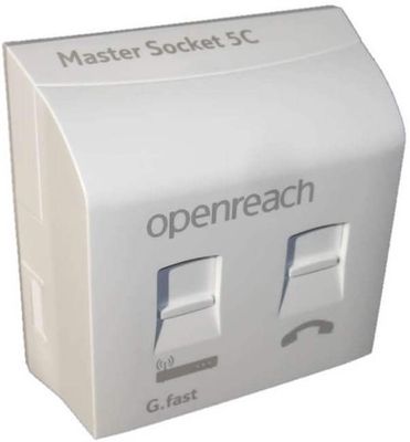

Message posted on 27 Oct 2024 09:31 PM - last edited: 27 Oct 2024 10:05 PM
Ultrafast 1 over G.fast (using the existing copper phone pair back to a fibre 'pod' in the street) requires an installer visit to fit a dedicated faceplate* to the master socket and check the resulting circuit is actually capable of carrying the 100Mbs guaranteed minimum download speed.
* with a different PCB and component selection to the standard Mk4 VDSL version so improving filtering up to 106Mhz

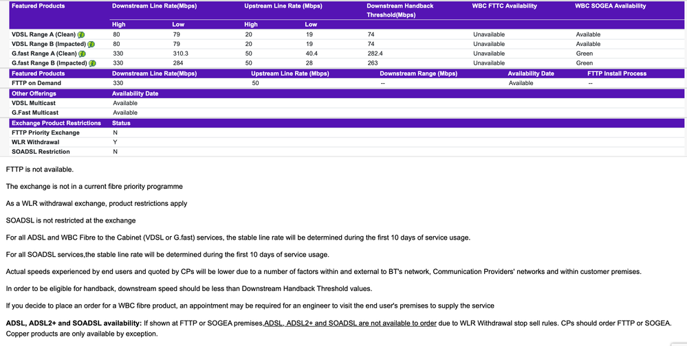

@skycustomer29 It's likley this is a full fibre install so it won't be using your exisitn g line.
Can you post the results from here remove any address data so the forum can confirm this

Message posted on 27 Oct 2024 09:02 PM
Re: Returning Sky Customer
@skycustomer29 The old copper line is going away and with you getting ultrafast 1 you will need a box connected to the outside of the property and then another box installed inside the property, this connects to your router to give you internet. The technology is different from the old FTTC which would only go up to 80/20.
This is why you need Openreach to come out to do the outdoor work and maybe the indoor work also.

Hi, Thanks for your response.
I do not think it is full fibre because according to openreach my home is not eligible for it yet.
When I entered my postcode with sky i only got 3 options , Superfast 36mb, Superfast 65mbps and 145mbps which is what i have opted for. When in went to BT the engineer said I've already got everything he plugged the router in activated it and then he left.

@skycustomer29 If you post the results from the link that @GD1 posted we can take a look for you if you would like.
