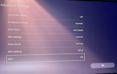

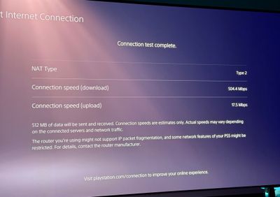

This message was authored by SlvrYeti This message was authored by: SlvrYeti
Re: PS5 IP PACKET FRAGMENTATION
Here's some photos for you:
