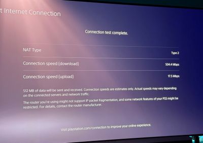

SlvrYeti
Level 1
Re: PS5 IP PACKET FRAGMENTATION
Message contains an image
Here's some photos for you:
