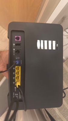

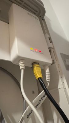

I moved into a new build and this is the Open Reach set up. There is no DSL cable but I understand the yellow ethernet is meant to replace that, but I connected that to port 4 on the sky hub and it doesn't connect. There is also a cable already attached that can't be removed but it doesn't connect anywhere on the sky hub, isn't that where the fibre cable should be? Can someone help me please

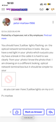

Message posted on 02 Oct 2025 06:45 PM
Re: New Setup not working
You should have 3 yellow lights flashing on the optical network terminal box it looks like you have a red light in your photo which surjusts you my have a break in the cable it is hard to see clearly from your photo I know the photo that I am showing on is a different looking optical network terminal box but it should be simpler to your
as you can see i have 3 yellow lights on my o n t

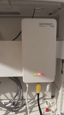

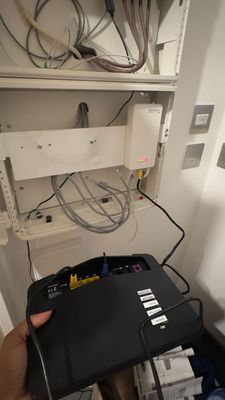

@pilotb The picture off you holding up the Sky Broadband Hub, yellow connected cable ends on the black cable to port 4, you should see the 2 Green lights on that port, LHS solid Green, RHS flashes with data to the ONT!
First picture with the RED lights looks more like a BBU unit and that is not where the Ethernet cable connects. butter front on picture is required, and coiled up fibre green connector looks like your ONT is not there!

Message posted on 02 Oct 2025 07:33 PM - last edited: 02 Oct 2025 07:34 PM
That's an interestingly complex setup.
The first thing to note is that the device you've plugged the ethernet into isn't any kind of 'hub': it's the Battery Backup Unit for an Openreach ONT (which appears to be in one of the other images)

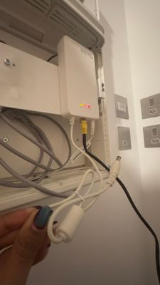

Message posted on 02 Oct 2025 07:34 PM - last edited: 02 Oct 2025 07:37 PM
@pilotb Get that yellow/black Ethernet cable out off the BBU unit IT DOES NOT GO THERE!
If the BBU is not functional as indicating, then you need to replace the Four batteries in the unit, that is your responsability to do!

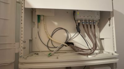

It looks like the ONT may be the device on the left in here:
A clearer picture of that would be useful.
Message posted on 02 Oct 2025 07:37 PM - last edited: 02 Oct 2025 07:40 PM
Or it could be the missing device which was once in the space here (note the mounting screws) :
Message posted on 02 Oct 2025 07:39 PM
@TimmyBGood Think the Green plug is for the ONT and it's NOT there at all!
Message posted on 02 Oct 2025 07:42 PM - last edited: 02 Oct 2025 07:44 PM
@pilotb With the Ethernet cables all hanging loose, and the fixing screw's would GO more with there used to be an 8 Port switch that has been removed and now gone, those cables all go out to points in other rooms! ? New build but you are not the first owner!
Message posted on 02 Oct 2025 07:44 PM
That doesn't affect the broadband connection itself though: it just lights up a rather misleading fault LED.
Message posted on 02 Oct 2025 07:46 PM - last edited: 02 Oct 2025 07:48 PM
There appears to be a green optical jack plug inserted into the partly concealed box, and perhaps another one laying loose below it.
I'd agree that it's probably an ethernet switch missing to the left of the BBU.
The whole setup appears to have been customised: I haven't seen a BBU and ONT that far apart before.
