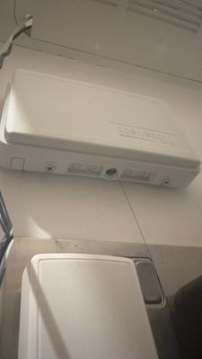

@pilotb Outside the two cabinet's that square below you are blocking with the holding off the sky hub, can you picture that front on as it could be an ONT there!

it's there but sealed no cable can be attached, just a loose string coming out

It's the device on the left here that I'm interested in:

OK, so that has twin optical jacks, but it's not an ONT.

Typically an ONT/BBU was installed inside an enclosure like this:

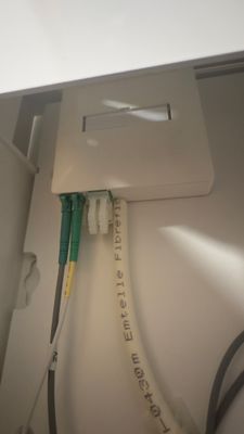

@pilotb On post 6 the picture what is the square box outside the cabinet, your picture is hiding it because you are blocking with the Hub!

it's this, but nothing can be plugged in it, not sure what it is

An Openreach box, but no visible connections...
The whole setup is distinctly eccentric.

@pilotb Ok got that and also on post 6 the BBU as you look at it, LHS cable that you may be holding also in your hand, that is the Power output and plugs into the ONT for power, also going to send you a video link for the replacement and how to change the faulty batteries.
If they are not change, power blips your unit may just not keep the ONT up.
BT Openreach Fibre ONT - How to replace Battery Backup Batteries for phone line
Looks like the previous owners have done a good clearout, taken the ONT, the Switch and left you well high and dry!
Probably one off those real old ONT combined lan switch arrangements from the link below and now obsoleted by OR anyway, so do expect something different and switch may just be needed for all those Ethernet cables wherever they are heading off too!
