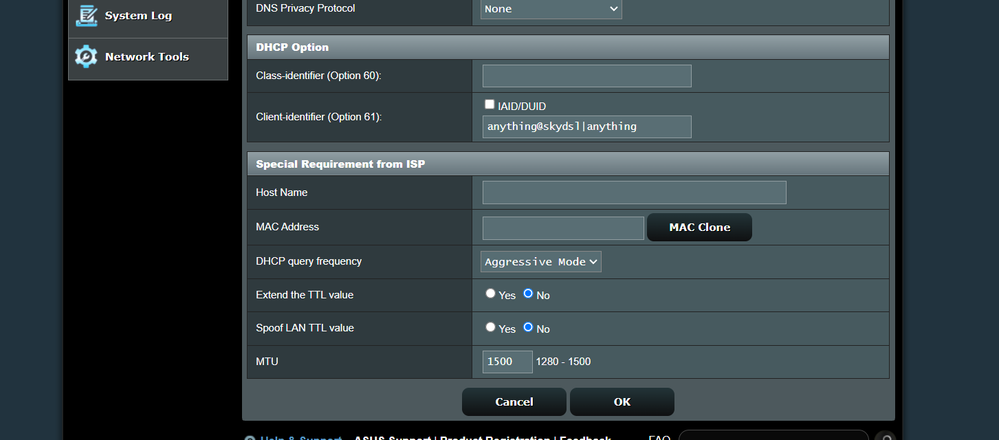

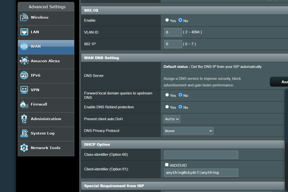

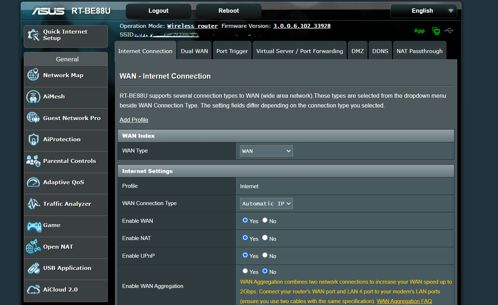

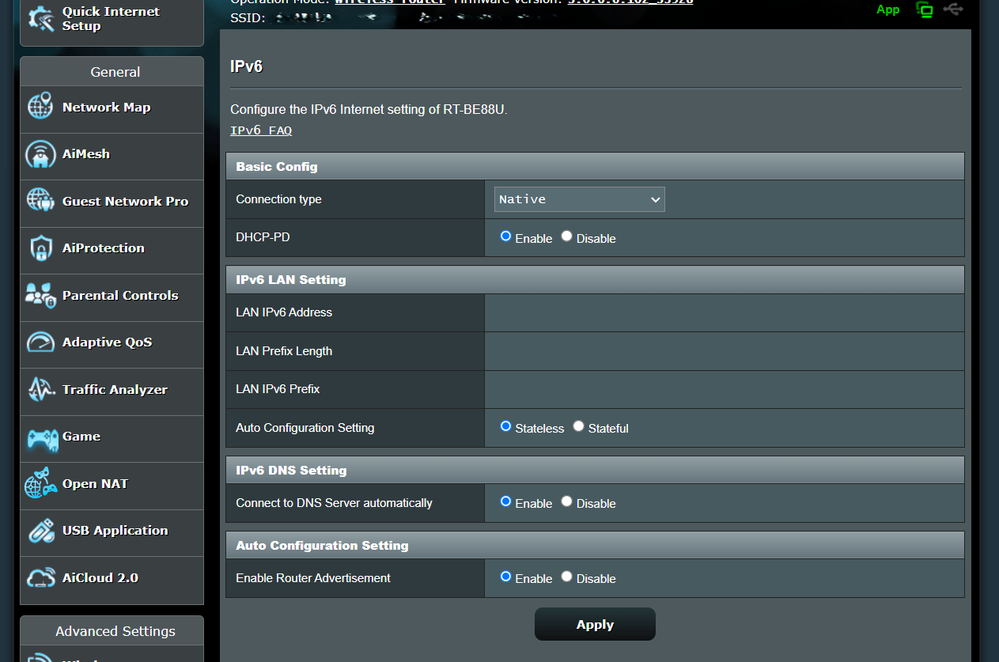

Hoping you can help with this one, trying to setup an Asus RT-BE88U but cannot get an internet connection.
I have FTTP connection with a OpenReach ONT in the 10G WAN port and a back up 4G connection into the 1G WAN port. Dual WAN enabled with failover enabled (primary set as the 10G WAN port). Only the 4G failover gets a connection.
I've searched through and found a bunch of threads but configuring the same has not yet yielded results.
My current config is below (sorry if they're not in the right order!). I have tried to change the query frequency between normal/agressive.
What am I missing?
