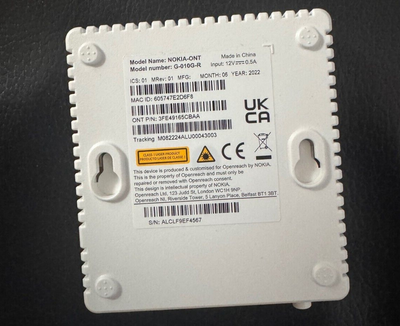

ONTs don't usually sit on a backbox and aren't designed to fit one: they typically mount on two screws put directly into a wall.
Cable ports are on the underside to facilitate this.

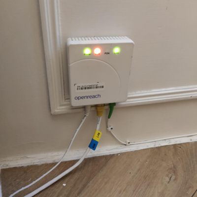

If you did manage to convince an installer to use an in-wall duct it might have to be something like this:
From the image it appears that in this case both router and ONT power source are elsewhere.
