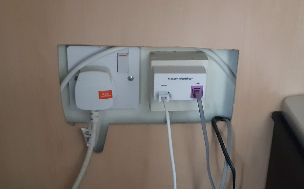

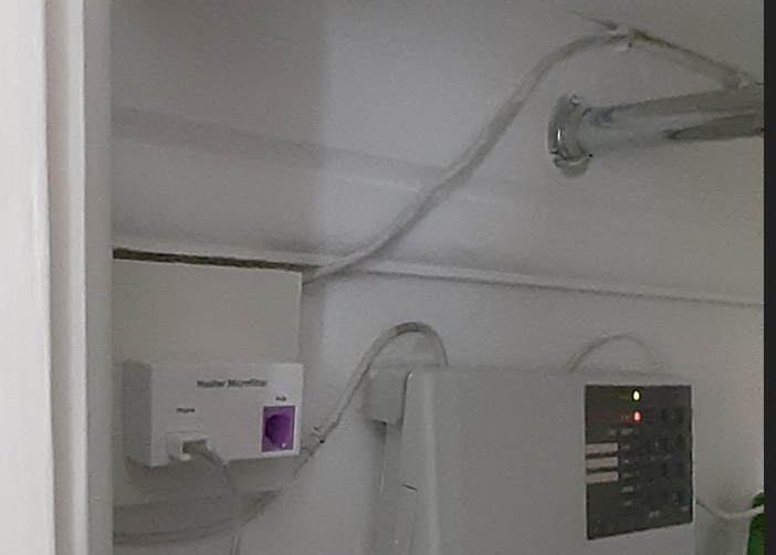

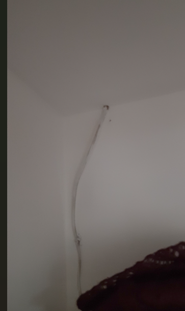

I'm actually wondering if I could do some pre-work, just looking around my house and set up. I wondered if I ask a private phone/broadband/wifi engineer out to look and maybe "pre-install" some ethernet cable from my downstairs cupboard up to the bedroom which is directly above. Currently the wire for the phone extension runs from the master socket in that cupboard up and through the floor to the extension socket in the room above. I'm even wondering if it easier to put some kind of ethernet socket in the cupboard, run the wire outside and up and into the bedroom (both cupboard and bedroom are on the outside wall) then have an ethernet socket in place of the phone extension.... I added some photos to show the set up currently... I know I would pay but hopefully having organised myself to install the extension wiring I could be more selective...
