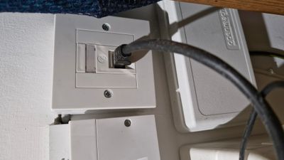

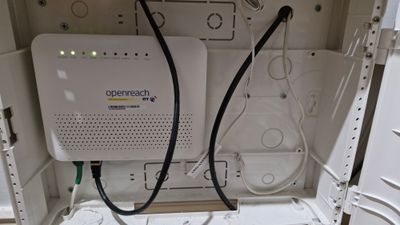

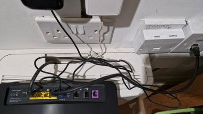

 The black wire on the left goes to my WAN port.
 i have port 1 going to this ethernet port 👇
 which leads to the floor above which I have my Xbox ethernet cable to.
So if I put the Wan cable in the port above then put that cable into router Wan instead of Xbox it should work?
