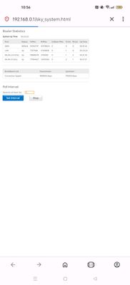

Right has anyone had problems or experience with this before, the ongoing issue of the router resetting from previous posts is still persisting even though I got a replacement router yesterday from Sky, when the resets happen the gateway is changing I try logging in on my phone but get page unavailable this is the 192.168.0.1 that I'm certain is there gateway, yet all devices can still connect.... So I still have internet but cannot get into the router settings to check the statistics or anything

@jamesn123 no reboot in 90 odd hours although the 5ghz must be dropping in and out but I am not noticing it judging by the 16 hours of uptime compared to the rest
