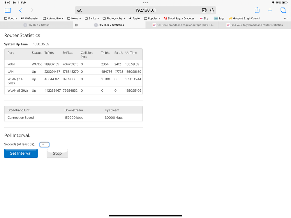

@Billc1952 Could you please post your router stats following the link below.

@Billc1952Connection has been up for around 183 hours, but that router uptime is a lot. Might be time to give it a re-boot and see if the connection settles down.

we have full fibre and as you can see from the stats I posted yesterday I am getting 159 mps.
