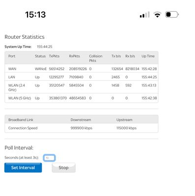

@OKCommuter Sky only guarantee the speeds to your router So looking at your router the speeds are higher than 600mbs .
How are you testing your speeds is it by wifi or by a laptop or pc etc connected by ethernet with nothing else accessing the router ?

Testing with Wireless or/and Homeplugs is not going to get you Gbps speeds, even the latest Sky Max Hub won't achieve those speeds over wireless.
Only reliable method of checking speeds at the Gbps level is over a direct wired ethernet connection with a device with SSD, fast processor and Gbps ethernet port.
Looking at the router stats it is achieving the Gbps speed over the fibre itself without issue, and really those speed are for busy lots of device connecting and working concurrently.

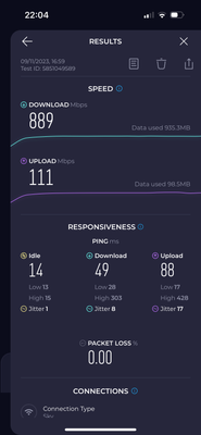

Message posted on 28 Jan 2024 10:05 PM
Re: Broadband speed
WiFi connection between sky max hub and iPhone 15 pro
Message posted on 29 Jan 2024 12:00 AM
Re: Broadband speed
