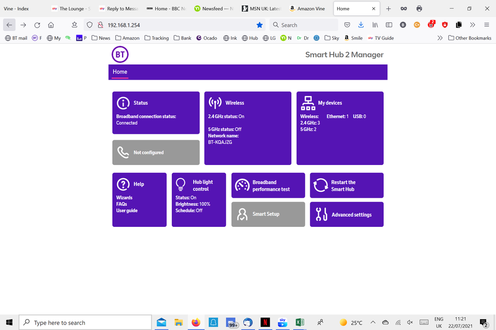

@BlackfishUsing the information on the pull out card on the BT hub log in as admin.
Click on "Smart set up" it then gives you an on/off option.
There are some other thinks you may have to do with smart hubs depending on what other problems you have.
Split the frequencies in the hub. (can't with the SH2)
Move the 5Ghz channel as far away from Ch36 as you can.
If none of the above work you can also narrow the bandwidth in the Q boxes. From 80 to 40
Screen shot below, you will only see it when the photo is approved
