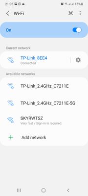

Just one thing I don't get is after disconnecting my sky router it still seems to show, see attached its SKYRWTSZ that's mad as its unplugged.
Cheers Vincey
Message posted on 27 May 2021 10:39 PM
Re: Replacing Sky Q Modem Router Suggestions??
Glad it's all working for you.
Not sure about the old network still showing. I renamed mine to the same as my old network.
Message posted on 27 May 2021 10:46 PM
I think the old router showing was my phone catching up, ots gone now.
