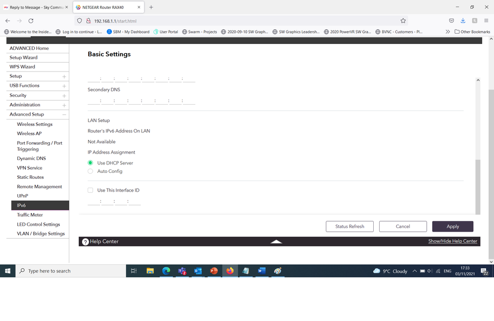

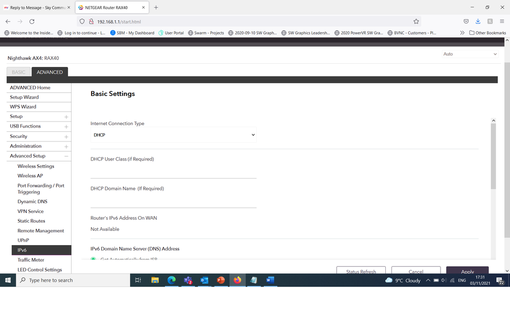

Weird. Is there no setting for DHCP-PD? See the screenshot below from my Asus router

Would have to recommend you post on the netgear forums to clarify if its actually supported and why IPv4 DHCP Option 61 isnt working either. Or just look at a different router
