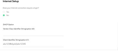

The need to clone the MAC address has long gone.
Simply enter the string abc123@skydsl|abc12345 into the DHCP Option 61 field.

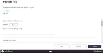

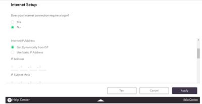

Thansk for the quick reply James, unfortunatley im still unable to connect. I have shared some scren grabs of the settings belwo, in case i have made a mistake.
Cheers

Looks right to me. Assuming you have Openreach ONT Port 1 > WAN port on the RAX40?
IP & DNS should be set to auto.
NAT Type is Symmetric.
WAN MTU 1500.
DHCP Query frequency continuous

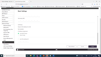

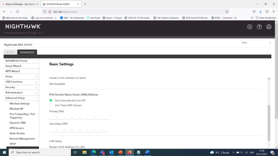

Message posted on 02 Nov 2021 08:00 PM
Re: Netgear RAX40 replacing Sky Hub FTTP
The Netgear router should have. Check under Advanced > Advanced Setup > IPv6 then WAN.

Message posted on 03 Nov 2021 01:17 PM
Can you send screenshots of your IPv6 config?
