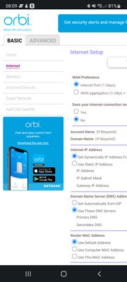

@VickyH831 I have the orbi mesh system too. I've changed the dns to 1.1.1.1 and my glass is now working fine, I had to try it a few times though as it didn't work straight away. Which orbi router are you using ?and I'll try help you with it.

@VickyH831 I've just looked at my settings and taken screenshot of them. Hopefully they will be of some help, I've got the orbi rbr750 with 2 satellites.
I'm assuming you've logged into the orbi Web page. This is what mine looks like, under basic, Internet, change the primary dns to 1.1.1.1 leave the secondary empty.
then remember to hit apply.

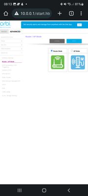

Under the advanced tab select make sure it's running in router mode and click apply again.
