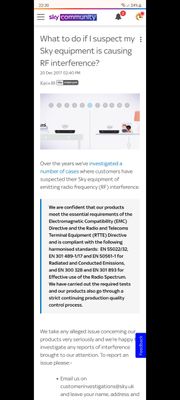

There is online presence about this issue on the Sky website. I have emailed twice but without a response to date. I am only reporting what I can hear unfortunately. It's actually keeping me awake at night as the noise is so loud. If you put the mains cable touching the coaxial cable the humming becomes louder. 😞
I remember that particular issue which I'm sure was resolved. It was to do with interference from Sky equipment breaking through to amateur radio reception. I don't think there's any connection with what you're experiencing.

Re: Sky cable is ungrounded and making a whirring / clicking / humming nosie
That's specific to the built-in Powerline data networking which was part of Sky Q on its release in early 2016.  This was never officially switched on but remained a user-accessible option for about a couple of years before its removal from firmware: Sky never admitted why this was, but one suspicion is they somehow had missed the required specification.  Subsequent Q hardware releases such as the 1TB UHD/HDR model which has been the default since late 2019 don't contain any Powerline technology.
