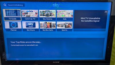

Hi,
I've seen many posts on here about how you can use a Sky + HD box as a Freesat box when your subscription ends.
I've tried doing this, however I get a error code 25 (no signal) and the guide is stuck on Your Box Is Still Initialising.
The dish worked perfectly fine with the Sky Q box (which were sending back) yesterday. The HD box hasn't been powered on in a bit over a month.
Any help on how to get this fixed?
Thanks 🙂

The LNB on the arm of your dish was,changed for Sky Q. It's not compatible with Sky+, hence the no satellite signal error. You would need to get the LNB changed back to a standard model for Freesat.

Ah, that will be why then.
Thanks very much 🙂
