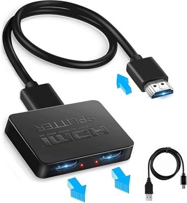

@Phill20 have you tried an externally powered splitter? A splitter which derives its power from the HDMI sockets of the attached devices is unlikely to work.
The modulators I mentioned previously do indeed use the RF coax cable already in place to send the signal from your Sky box's HDMI socket to your TV's aerial socket. There are modulators available which have a built-in HDMI splitter so that you can use the lolcal TV as well as send a signal to the second TV via the modulator.
I'm guessing that's what the USB lead in the image I posted above (randomly acquired online) is for. Presumably it's a potential use for the otherwise inexplicable USB port on Sky+ HD and Sky Q boxes...
