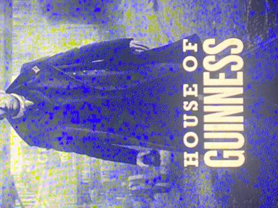

Sorry I've not posted for a while, I'll been using tv to us Netflix but this are the pictures I get when streaming

@John756 Thanks for your reply. My suggestions were not a guarantee of solution but usually one or two can be the reason for the poor picture. Have you checked your setup to see if it is that that is causing the problem. Often just experimenting can help?
